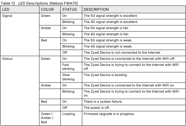

- During the offline period, are you still able to reach the device and access its local web GUI? Also, what is the LED status? You may refer to the table below.

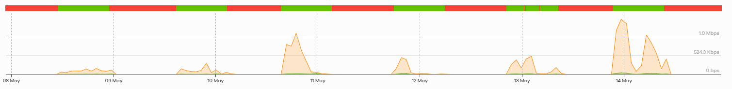

- the events look like periodic:
thanks
