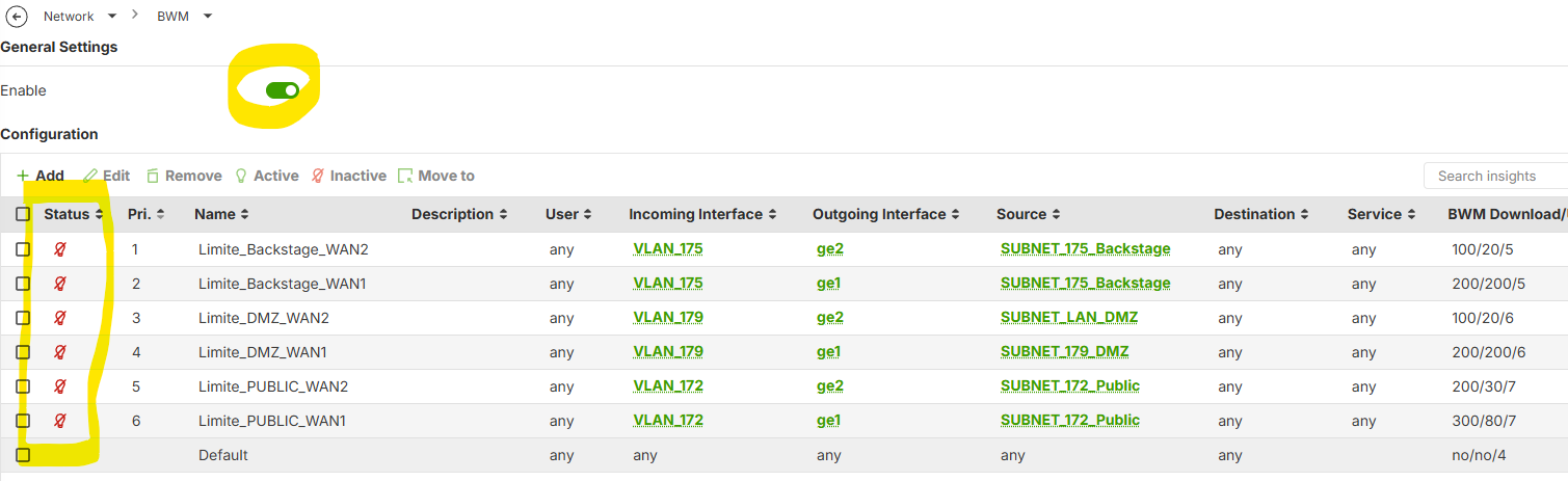

One example is a Shared BWM rule with:
  • Incoming interface: VLAN 172
  • Source: full subnet of VLAN 172
  • Outgoing interface: WAN
  • Destination: any
  • Service: any
  • Upload limit: 80 Mbit/s, just for testing
The problem is that this limit also affects traffic that should not match the rule.

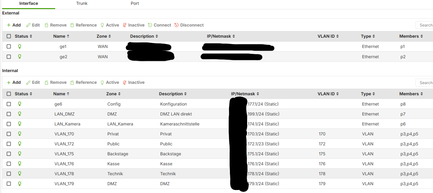

I tested this directly from a dedicated configuration port (p8) on the firewall. This port is not part of VLAN 172 and is not subject to any intended bandwidth restriction.
I also repeated the test on several different WLANs assigned to different VLANs. All of them show the same behavior: as soon as BWM is globally enabled, the upload speed is limited to roughly the value configured in one of the Shared BWM rules, even though the corresponding rule is disabled and the traffic originates from a different VLAN.
Results:
  • BWM globally disabled: about 700 Mbit/s upload
  • BWM globally enabled, but all custom BWM rules disabled: about 80 to 90 Mbit/s upload
  • The same behavior occurs on several different WLANs and VLANs
  • The measured value corresponds closely to the 80 Mbit/s upload limit configured in one of the disabled Shared BWM rules
All custom BWM rules are shown as disabled in the local GUI. The default BWM rule has no bandwidth limit configured.
This shows the relevant interfaces and confirms that the test client is connected through a separate configuration port p8 and not through the VLAN affected by the BWM rule.
This looks very similar to the behavior already described earlier in this thread, where a Shared BWM rule for one VLAN also affected traffic from another VLAN, and disabling the rule did not fully remove the bandwidth restriction.
In my case, disabling BWM globally immediately restores the expected upload speed.
I found another important detail while testing:
The order or priority of the BWM rules themselves does not seem to have any effect. Instead, the upload traffic is always shaped according to the values configured in the rule with the lowest Traffic Shaping priority, regardless of whether that rule should actually match the tested interface or VLAN.
I also confirmed that this behavior only affects the upload direction. Download traffic is not affected in the same way.

    Thank you for providing such a detailed breakdown of your test environment, scenarios, and the corresponding configuration screenshots — this allowed us to run a local test. However, on our side, the speed of a PC connected to Port 8 (which doesn't belong to the VLAN with BWM applied) is not being limited.

    We were able to reproduce the symptom in a corner case: when there's a BWM rule using the same outgoing interface as the traffic being tested, and its priority is lower than the default rule. And when there are several BWM rules configured, the test upload speed is affected by the upload limit set in the lowest-priority BWM rule.
    We'll investigate this further and update you with any findings.
