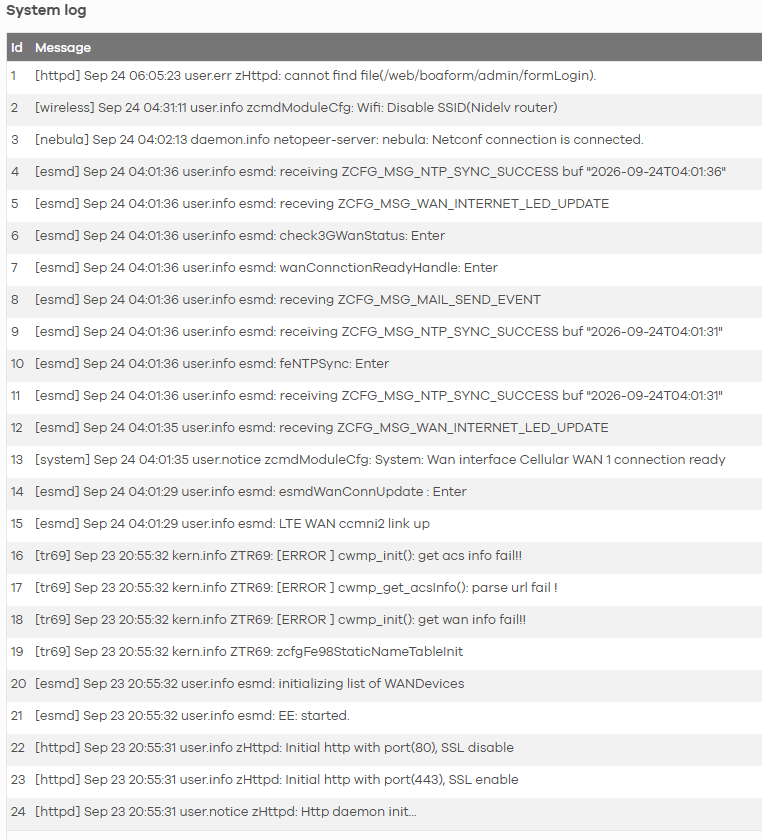

We have a FWA710 router which is going offline in time to time (daily). Sometimes minutes before going back online, sometimes for hours and needs to rebooted to get online. We have good 5G signal (less than -85db). This is what I find in the log, device went offline at 20:55, got online at 04:00 (Scheduled reboot). What could cause the device going offline and not back online?

    Hi @JonBl ,
    Based on the system log screenshot you provided, at 20:55:31, the device's system services (such as HTTP daemon and EE) were initializing or restarting. During this process, the WAN interface failed to establish a cellular connection, resulting in the errors [tr69] [ERROR ] cwmp_init(): get wan info fail!! and get acs info fail!!. Because the WAN connection failed to initialize at that moment, the device stayed offline until the 04:00 scheduled reboot successfully brought the connection back up (Cellular WAN 1 connection ready and Netconf connection is connected).
    This behavior typically points to the cellular link dropping (possibly due to an ISP IP renewal or temporary tower drop) and the router failing to automatically recover the connection.

    If the issue still occurs after following the steps above, please help collect the system log (System Monitor > Log) before the scheduled reboot, and share with us the exact time the FWA710 goes offline.
