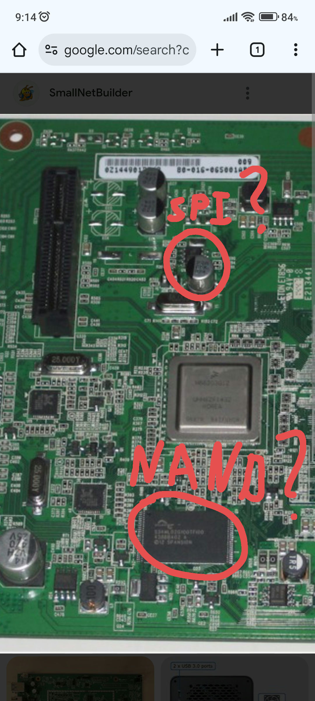

    The NAND chip is correctly located. About SPI, I don't know. Maybe you can ask @lesik1988, who seemed to have reprogrammed his SPI.
    I send you dumps of mtd0 and mtd1. (mtd0..2) are together the spi contents.

    1. A new problem arose in that the bootloader and borebox broke. The power button lit up and went out.
    2. Took 3 files: nas520_mtd0 + nas520_mtd1 + nas540.mtd2 kindly provided by Mr. Mijzelf.
    3. Combined them in a Hex editor. Got firmware for the Spi _Flash_542.bin chip
    4. Unsoldered the chip "mx25l8006e" (It is located on the back side of the board and is 1 MB) and installed it on the Chinese ch341 programmer.
    5. In spi there was data only from nas540.mtd2. Cleared and filled Spi _Flash_542.bin. Soldered it back onto the board.
