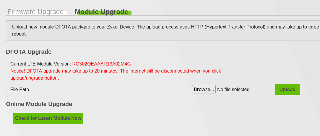

Which is the same of the firmware I've installed as you can see.
0 -
Thanks very much @Mayone78 for the screenshot.
This shows that your NR7101 is running 13A02 module firmware.
This means that the DFOTA upgrade file that you need is the one that is 13A02 to 13A04
Kind regards Tony

Same here, DFOTA Upgrade fails.
Current LTE Module Version: RG502QEAAAR13A02M4GUpgrade file name: RG502QEAAAR13A02-R13A04.zip

Same here. There is a version mismatch in respect of:
RG502QEAAAR11R13A02-R13A04
as listed here:
https://support.zyxel.eu/hc/en-us/articles/4403365084818-Zyxel-5G-Devices-NR-Series-Advanced-Downloads-Firmware-and-other-resources#h_01J7ZRPS4WKP2D0F6D46MPAEQ3
Look inside the zip file and the file "quectel-project-version":
Project Name: RG502QEA_ZYXEL_VA
Project Rev : RG502QEAACR13A02M4G_ZYXEL_01.001
Branch Name: SDX55
Custom Name: STD
Package Time: 2022-10-08,15:26Notice the AACR, but the modem reports:
ati
Quectel
RG502Q-EA
Revision: RG502QEAAAR13A02M4GThat is AAAR.
This gives an error 505 on upgrade (here attempted manually):
at+qfotadl="https://zyxeleurope.sharepoint.com/:u:/s/ZyxelSupportCampusEMEA/EfIaKh5A0-xHquodIeysno8BmgaVV5tTKMLfClLotWMi3A?download=1"
OK
+QIND: "FOTA","HTTPSTART"
+QIND: "FOTA","HTTPEND",0
+QIND: "FOTA","END",505
which relates to a version mismatch.
