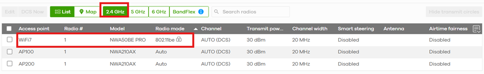

    Please go to Site-wide > Configure > Access Points > Radio Settings, check whether Radio mode is configured as 802.1be. If yes, please choose another radio mode. The reason is that 802.11be mode mandates WPA3 security as the only supported option. Even if you configure an SSID with WPA2 settings, wireless clients connecting to this SSID will be automatically upgraded to WPA3.

    radio mode was set to auto (up to 802.11be) for 5GHz and auto (up to 802.11ax) for 2.4 GHz
    I set it to 802.11ax (not sure if this means only 802.11ax or up-to 802.11ax). Nevertheless now MAG544 connected to 2.4GHz but still fails to connect to 5 GHz. If I use a 5g only ssid it never connects

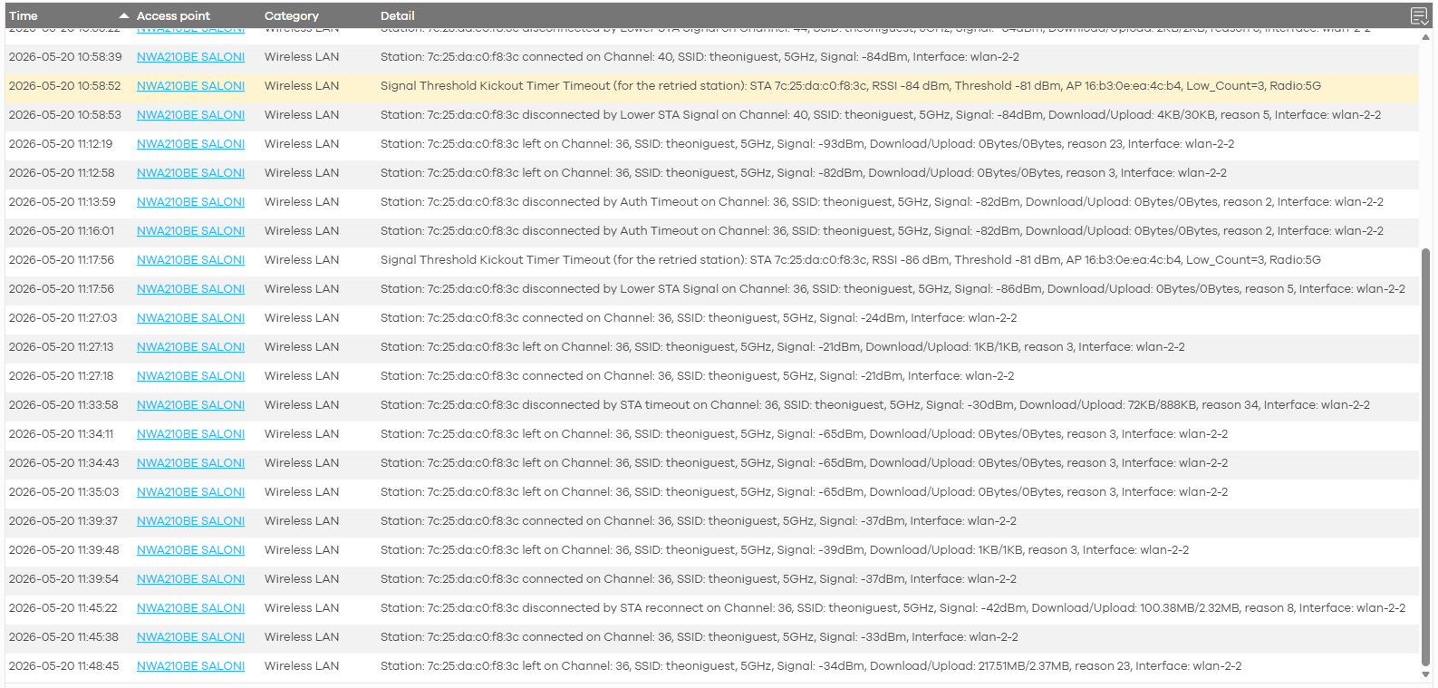

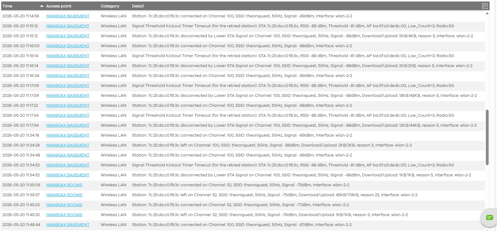

    Based on the issue time you reported (May 20, 11:47 UTC+3), we reviewed the logs from before that point and found the following:
    NWA90AX (BASEMENT) – Channel 100: The MAG544 was repeatedly disconnecting because the signal was too weak, falling below the -81 dBm disconnect threshold you configured for 5 GHz. The device then roamed to the NWA90AX (ROOMS) access point.
    NWA210BE – Channel 36: Your NWA210BE is fixed to channel 36. The MAG544 was also repeatedly disconnecting from this AP for the same reason — signal strength below the -81 dBm threshold. However, when the MAG544 moved closer to the NWA210BE and the signal improved, it was able to maintain a stable connection.
    Recommendation: Based on this behavior, we suggest changing your NWA90AX PRO NWA90BE PROfrom current channel 52 (DFS) to channel 36, keep the close distance then reconnecting the MAG544. This should help the device establish a more stable connection with a consistent channel configuration.
