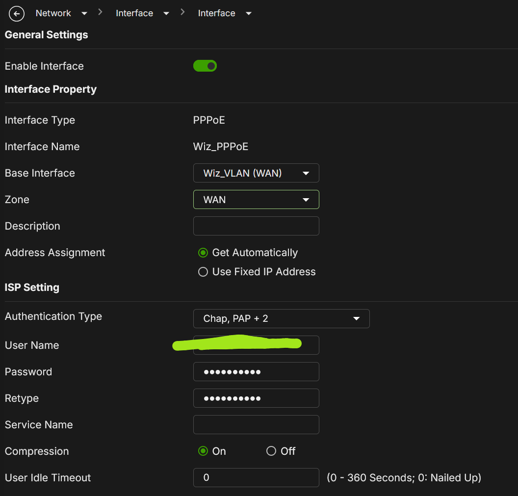

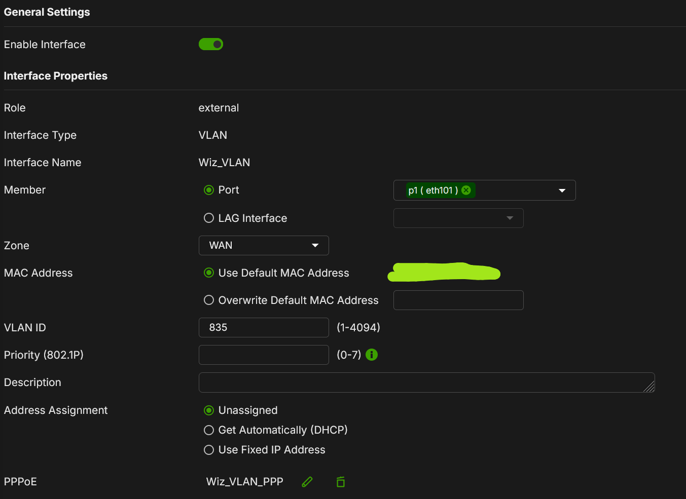

I've also an USG Flex 500H and I can successfully configure and establish the PPPoE on port P1 with the same VLAN/PPPoE params.

Seems that here, the problem was the Service Name, that after configured blank/empty, the connection was succeeded.
In my Flex configuration, the Service Name exists as field and is empty, meanwhile I don't find this field into the FWA.
Other things: what is/are the authentications type used by FWA? Chap? Pap? MSChap?
Because, my FLEX have all of this selected, into the FWA I don't find the authentication type mode.

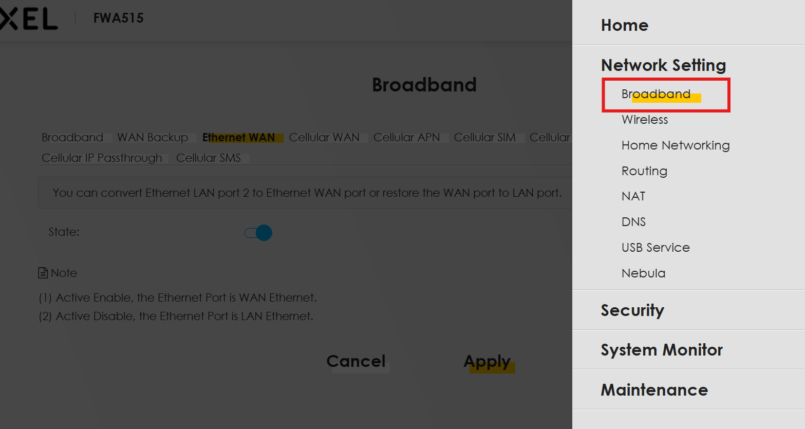

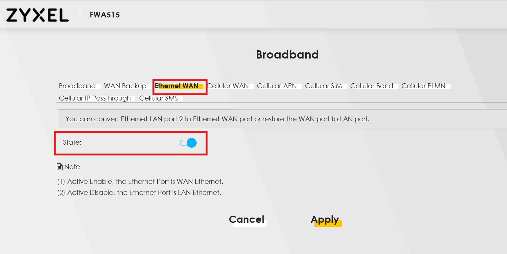

Hi @Maverick87 ,
Could you please check if the State is enabled under Network Setting > Broadband > Ethernet WAN?
0 -
Hi @Zyxel_Luna,
Yes it's enabled…
I've also tried to put on the 500H, inside the field "ServiceName" a word as "blablabla" and the PPPoE goes up&running successfully, so seems that is not a how the service name is set. Also for the compression, change to ON or OFF, is equal… the PPP goes up&running.This is my 500H is set:
- VLAN
- PPPoE
I've seen that only with PAP Authentication Type, the PPP was in success; with any other auth type fails. What are the default Auth Type for the FWA? How I can change the Auth Type since I can't do it via GUI?
