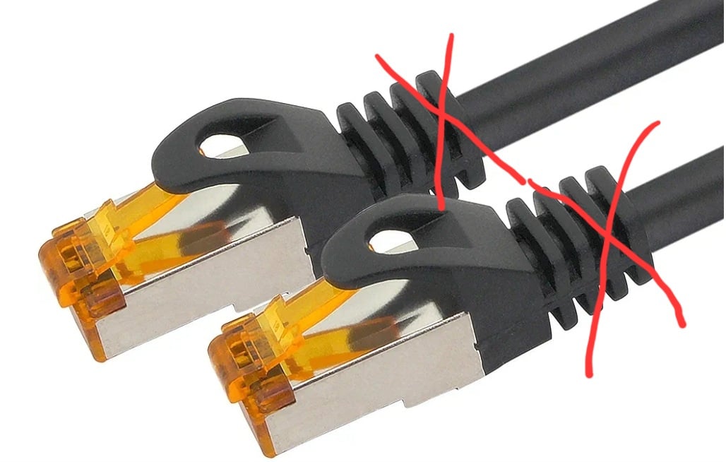

    After many days of watching, testing and replacing of almost all hardware and software options, I have found the troublemaker:
    The LAN cable was too tight pressed into the socket of the Zyxel FWA710.
    I removed a big part of the kink protection of the cable and cut a big cone of the rubber at the LAN connection, so that the cable wasn't tightly pressed anymore into the socket.
    The speed drops from 1000 to 100 MBit/s and the regular LAN disconnections stopped since I have done this.
  • TommyH

    My problem is solved. The kink protection at the LAN outdoor cable plug and the rubber seal forced the cable too tight into the socket.
