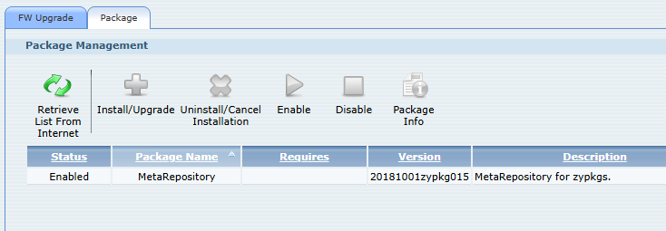

Hello there,
Im struggeling with installation of packages. I was able to install MetaRepositiory, but thats all.
I cannot see any packages. My package list looks like that:
in the "zy-pkgs" fille:
From web interface Im not able to do any changes:
I have Zyxel NSA 325 V2
Thank you for any help
0 -

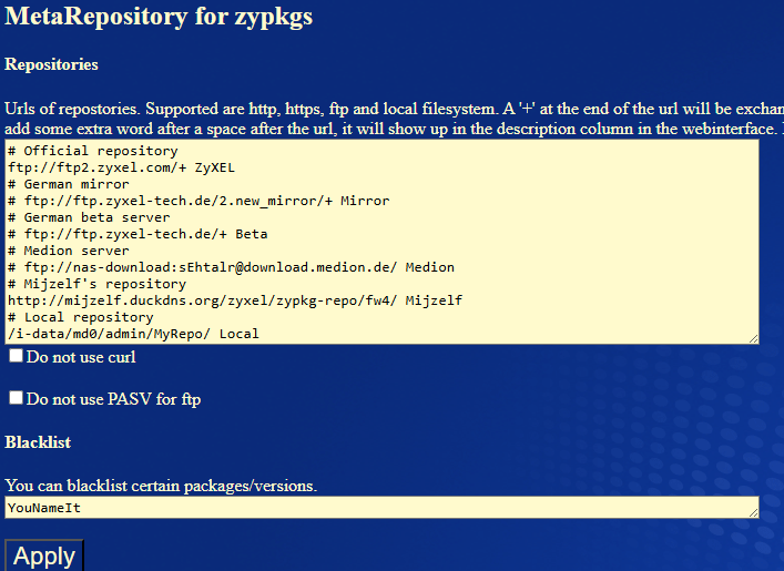

There should be a logfile in \\admin\zy-pkgs\MetaRepository\ which tells why it doesn't work.
0 -
Hello, below my log. Any suggestion how to solve it?
HandleZYPKG_INFO /NSA325-v2/4.80/zypkg
FindApp md5sum found /sbin/md5sum
ReadConfig Repositories
Start of block
ftp://ftp2.zyxel.com/+ ZyXEL
http://mijzelf.duckdns.org/zyxel/zypkg-repo/fw4/ Mijzelf
/i-data/md0/admin/MyRepo/ Local
End of block
8 start: 21:02:58
9 start: 21:02:58
7 start: 21:02:58
9: FetchZYPKG_INFO ftp://ftp2.zyxel.com/NSA325-v2/4.80/zypkg/ 9 ZyXEL
8: FetchZYPKG_INFO http://mijzelf.duckdns.org/zyxel/zypkg-repo/fw4/ 8 Mijzelf
7: FetchZYPKG_INFO /i-data/md0/admin/MyRepo/ 7 Local
7: FindApp curl found /usr/bin/curl
9: FindApp curl found /usr/bin/curl
7: Fetch /i-data/md0/admin/MyRepo/ZYPKG_INFO.tgz /i-data/md0/admin/zy-pkgs/MetaRepository/_i-data_md0_admin_MyRepo_.tmp failed
7: Fetch /i-data/md0/admin/MyRepo/ZYPKGS /i-data/md0/admin/zy-pkgs/MetaRepository/_i-data_md0_admin_MyRepo_.tmp failed
7: Failed
8: FindApp curl found /usr/bin/curl
7 stop: 21:02:59
8: Fetch http://mijzelf.duckdns.org/zyxel/zypkg-repo/fw4/ZYPKG_INFO.tgz /i-data/md0/admin/zy-pkgs/MetaRepository/http___mijzelf.duckdns.org_zyxel_zypkg-repo_fw4_.tmp failed
8: Fetch http://mijzelf.duckdns.org/zyxel/zypkg-repo/fw4/ZYPKGS /i-data/md0/admin/zy-pkgs/MetaRepository/http___mijzelf.duckdns.org_zyxel_zypkg-repo_fw4_.tmp succeeded
8 stop: 21:02:590 -
Right.
You can see here that MR tries to fetch ZYPKG_INFO files from 3 sources. As expected. You can see that task 7 and 8 finish, but 9 (ftp2.zyxel.com) doesn't.
Normally, when all tasks are finished, this log is supplemented with info about merging of the collected ZYPKG_INFO files. This part lacks.
I tried to manually connect to ftp2.zyxel.com, and it timed out in 5 minutes. The MR script runs within a webserver task which tries to generate an answer to a request of the package manager. I suppose the package manager didn't wait 5 minutes for an answer and cancelled the request, causing the running MR script to be killed.
Apparently, ZyXEL has shutdown their server. Well, there was no more '325 data on it anymore. So the remedy is to remove the ftp2.zyxel.com line from the config.
