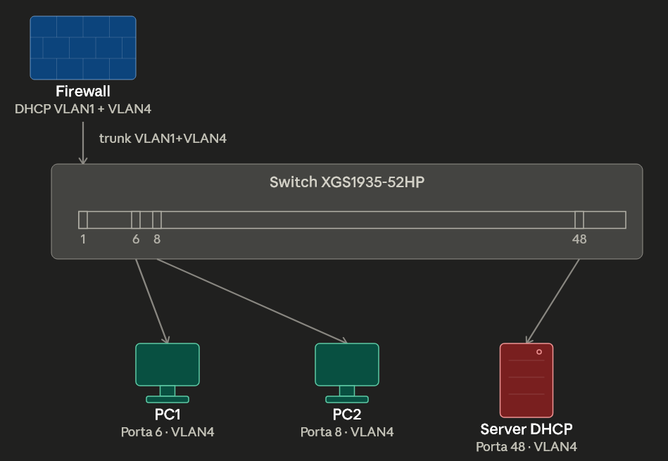

These days I've been doing several experiments to fully understand all the features of Zyxel switches.
I've understood how RSTP works with BPDUs and Loop Guard, but now I need to understand DHCP Server Guard.
I connected the link of a switch (XGS1935-52HP) to port 1, VLAN1 (MGMT) and VLAN4 (DHCP VLAN1 Firewall 192.168.1.x; DHCP VLAN4 Firewall 192.168.4.x).
Then I connected a computer to VLAN4, and I'm receiving IP addresses correctly. (192.168.4.5)
The same thing happened for PC2, which received the address correctly.
I then connected a cable from another switch with a DHCP server 172.16.5.x to port 48, again VLAN4.
For example, if I unplug PC 2 and then plug it back in, I notice that all the lights start flashing and the PC doesn't receive any address, or after a while, even 172.16.
Where can I set that only port 1 is allowed to release IPs?

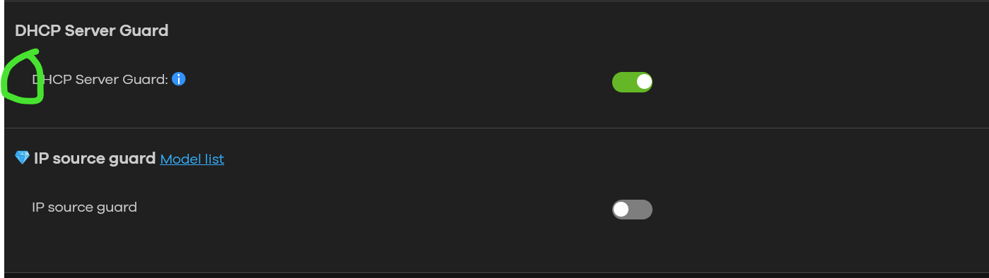

  • Alex_91
    Alex_91 Posts: 64
    First Comment Friend Collector Eighth Anniversary
    image  Ally Member
    HI, @Zyxel_Judy
    yes, all port of switch blinking. Maybe the question is, how to configure DHCP server guard correctly in nebula?
    because I followed the first part of this post:
    I enabled only the option, but there are other things to do? (in this case I would like to point out that I don't have Nebula Pro)

    But, you are sure? Why in Configure → Switch → switch settings:
