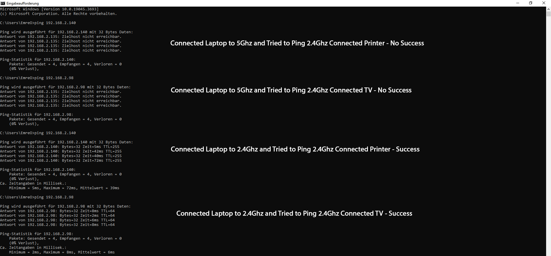

Im checking using the Nebula App (i know about the delay on it) + determine via Wifi Signal, since the upper floor AP is 2 floors up, the cellar AP signal is nearly impossible to reach the 2nd upper floor so i can see the Wifi Signal is switching from nearly 0% up to 100% on the Laptop since im staying next to upper floor AP.iPhone used "Ping - network utility" from App Store by lurii Mozharovskyi
Laptop used Windows CMD for PingDevices used to Ping:
iPhone: <hide due to privacy>
Windows Laptop: <hide due to privacy>Devices tried to Ping (Both Connected to 2.4Ghz Only Network on Cellar AP):
HP Printer: <hide due to privacy> / 192.168.2.140
Samsung TV: <hide due to privacy> / 192.168.2.98AP's involved:
AP Cellar: <hide due to privacy> / 192.168.2.194 - "Keller"
AP Upper Floor: <hide due to privacy> / 192.168.2.185 - "Obergeschoss"Laptop - Connected to Cellar AP
12:56:00 - 12:56:30 - Connected Laptop to 5Ghz and Tried to Ping 2.4Ghz Connected Printer and TV - No Success
12:56:45 - 12:57:00 - Connected Laptop to 2.4Ghz and Tried to Ping 2.4Ghz Connected Printer and TV - SucessiPhone - Connected to Cellar AP
12:59:00 - 12:59:40 - Connected iPhone to 5Ghz and Tried to Ping 2.4Ghz Connected Printer and TV - No Success
13:00:15 - 13:00:45 - Connected iPhone to 2.4Ghz and Tried to Ping 2.4Ghz Connected Printer and TV - SucessLaptop - Connected to Upper Floor AP

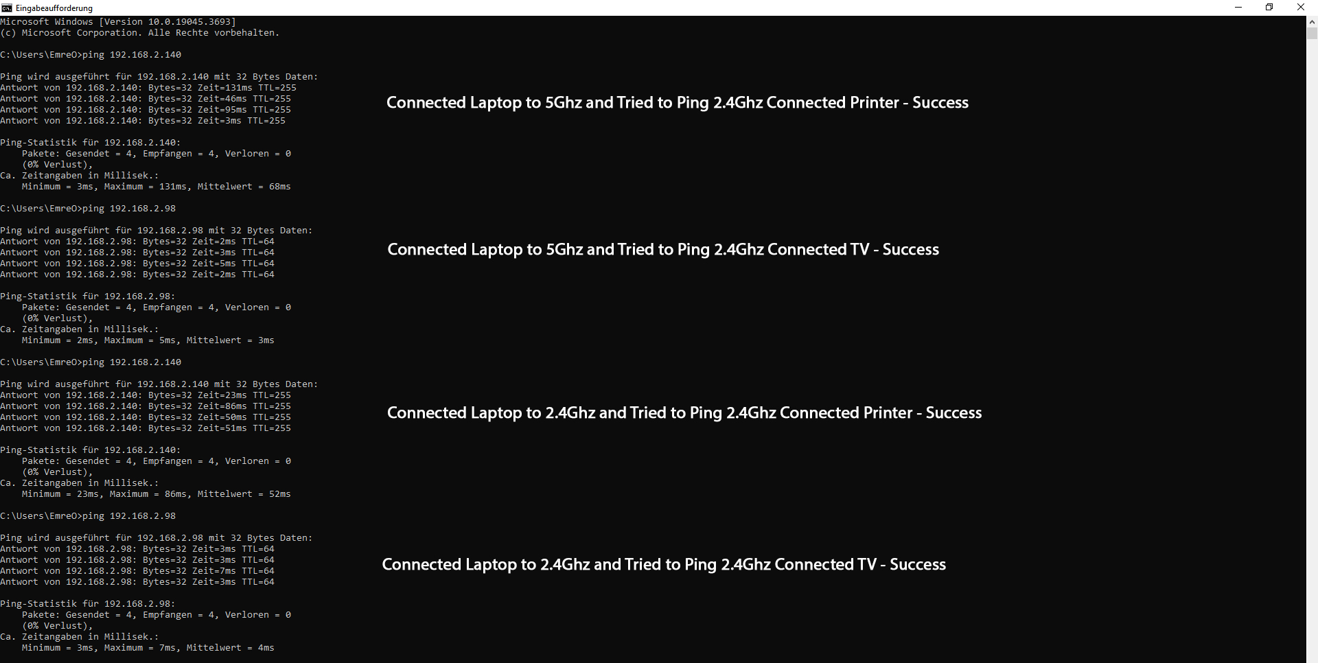

13:03:00 - 13:03:30 - Connected Laptop to 5Ghz and Tried to Ping 2.4Ghz Connected Printer and TV - Success
13:03:30 - 13:03:45 - Connected Laptop to 2.4Ghz and Tried to Ping 2.4Ghz Connected Printer and TV - SucessiPhone - Connected to Upper Floor AP
13:05:15 - 13:05:45 - Connected iPhone to 5Ghz and Tried to Ping 2.4Ghz Connected Printer and TV - Success
13:06:00 - 13:06:15 - Connected iPhone to 2.4Ghz and Tried to Ping 2.4Ghz Connected Printer and TV - SucessI also found a Thread with the same Topic and nearly same AP, which could be fixed with an Firmware Update by Zyxel 2 year's ago.
